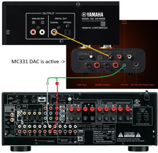

Seem like the chain you want is this:
1. Yamaha CD- player Coaxial (Digital output) > MC331 Coaxial (Digital Input).
The CD player DAC is bypassed; digital data is transmitted to MC331.
2. MC331 3.5mm (Analog Pre-out) to Denon receiver RCA (Analog Input L/R) - for example CD/TAPE IN.
MC331 DAC convert the digital signal to analog audio and transmitted it to the Denon receiver.
The amplifier of MC331 will be bypassed; Denon Receiver will be amplifying the sound to the speakers.
Here's a diagram of the wiring.
Is this a better audio quality? Maybe.
You have DAC in all of those 3 devices that you can experiment with.
1. CD player Analog Out - > Denon Analog CD/TAPE IN (This uses the CD Player DAC).
2. CD player Digital Out - > Denon Digital Input (This uses the Denon DAC).
3. CD player Digital Out - > MC331 Digital Input - Pre-out -> Denon Analog CD/TAPE IN (This uses MC331 DAC).
