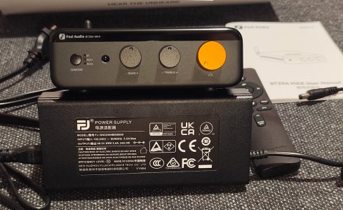

It's immediately clear that the design is new, obviously I'm mainly thinking of the front panel here. It's different from what we're used to. It has a designer, rounded front panel. With a plastic decorative strip on top. This is the first device with all four edges of the front panel rounded. We find a power button on it, which is also the channel selector. Here we can see that we have 3 input channels. We see a series of LEDs that indicate the currently used input, the remote control sensor, an equalizer and a motorized volume control. The layout is very logical, I like it too.

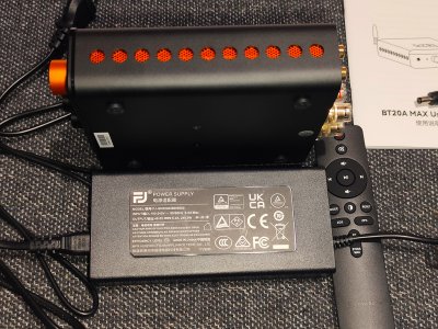

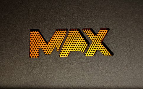

The housing is reminiscent of the v3 mono design. We also find the round side ventilation openings. It finally got a top opening where the heated air can escape. This is the MAX inscription itself. We know from physics that the flow of hot air rises upwards. It got a significant help for ventilation: a built-in fan, which is relatively quiet. The ventilation MAX inscription visible on the top of the housing is equipped with a perforated orange insert plate like the side vents. We can hear a discreet rustling (and airflow) from close up during operation. Since I sometimes listen to music very quietly, I hear it, and during the break between two songs can hear, which bothers me. A basicnoise during the break. After a few days of use, I couldn't get used to it, so I took it apart and pulled off the fan's contact lug because it can still ventilate through the slots and checked if it overheats. I don't encourage anyone to do this, but there was no significant heating. After a few hours of use, without active cooling, I measured 33-34 degrees Celsius. I've been using it for two days now without active cooling, with normal room volume, and there is no significant heating. So far, it has never exceeded 34 degrees Celsius. Unfortunately, I haven't measured it with the fan running before, but when I touched it with my hand, the heating was very similar. It may be that the change is only minimal. I don't want to disassemble it again for accurate measurement, I will obviously monitor the temperature in the long term and if necessary, I will restore the active cooling. If I ever notice overheating, and I need to reset the factory cooling. I will report it in the article or in a comment.
I couldn't get used to the sound of the cooling fan.
Many people are reassured by the fact that it has active cooling. It bothers me. We are not all the same...

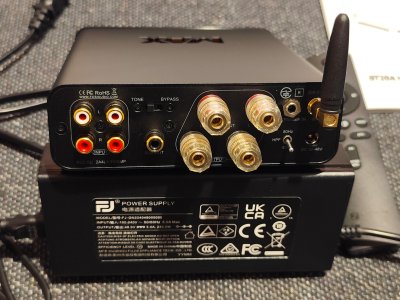

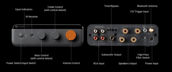

From left to right we find two RCA inputs. Then a bypass button to turn the equalizer on and off. Below that we find a sub output, then the speaker outputs. These are easy to use with your fingers, not too small. They are larger than the v3 banana sockets, the same as the LC30 banana sockets. They are better because they are big enough for your fingers to comfortably reach and tighten well, but unfortunately they do not fully accept the standard banana plugs. Only about half.
AudioQuest SureGrip 100 BFA:
They are not deep enough. In any case, the connection is stable. The sockets are not loose. They hold the plugs tightly. I think this may change in the future if possible. It would be nice if they were made of copper and gold plated. These banana jacks are similar on several of their devices. I recommend that in the future we use a jack that accepts standard plugs along their entire length, and is also big enough to comfortably reach and tighten them if we are not using the plugs, but clamps or a fork. Let's move on. Next is the trigger input. There is no output, so further chaining (stitching) with a trigger is not possible. (This is not a problem, because it is not needed at the end of the chain, just an option) Below it we find a high-pass filter switch, which, when using a subwoofer, cuts off the bass from the main output at 80 Hz and sends it to the subwoofer output so that we can use the 2.1 system. Next to it are the bluetooth antenna and the power supply input.

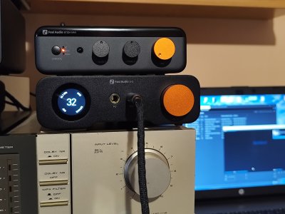

From the external dimensions it is clear that we cannot really pair this amplifier (on top of each other) with any other Fosi product. If it had been a little wider, it would have matched the members of the za/zd/zh series and then there would have been room for a balance button on the front panel, which would be a great help for those listening to music in an asymmetrical room, and perhaps an additional RCA input and a trigger output on the back panel. This is just my imagination. But this way, it would have fit into the family of existing devices with its dimensions. But it was not designed for an existing device family. This is a new device. Used separately, it is a very nice device. It should be treated as such.

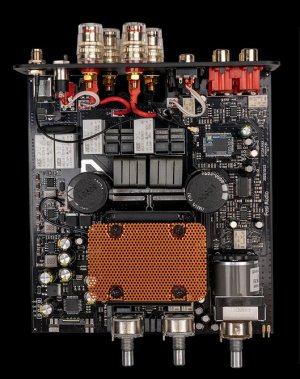

Since I already took it apart because of the fan, I also updated the op amps, although the ne5532 is a very good op amp, but I hear it as thin and digital to sound, so since I had many opa1612 and opa1656 and oracle II 02 at home in reserve, I put the opa1612 in it.
Note: The possible versions for modifying the op amps are limited because the integrated cooling fan reduces the space, so only normal height I.C. s can fit without removing the entire fan. Since the op amps are under the fan and a little further in, some manual dexterity is required
I spent days doing a/b testing using the lc30 so that there would not be a momentary pause in listening when switching. I have to say that (I repeat) everything that can be said about the v3 monos in terms of sound quality is also present in the BT20, even the stereo space is slightly better, and I really like my monoblocks and I think the op amps are better in them (akliam LC5). That's why I'm going to get negative comments because according to the measurements there's nothing audible between the op amps. But I feel like these aren't expensive op amps, and some of them I can't hear better because I spent too many dollars on them. Even among the similarly priced ones, there are some that I've thrown away because I liked one and not the other. For example, the opa1656. For me, this sound is not right. That's all for now. Let's skip on this theme..
Another positive observation: The buffer capacitors in the BT20A Max are larger than those built into the V3 Mono.
