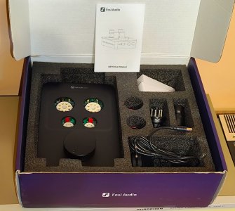

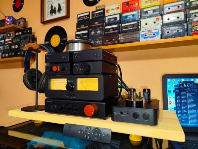

I recently received a new headphone amplifier and preamplifier from Fosi Audio. This little jewel box is called the GR70. Let's see what we get first, the contents of the box:
1. The GR70
2. 2 pcs 5654W tubes
3. 2 pcs 6Ж4 tubes
4. Wall power supply.
5. User manual
After assembly, you may understand why I called it a jewelry box. I really like it! It can also be a decoration for the table.
I will introduce the device in two parts. Let’s see the first impressions and the use as a preamplifier.

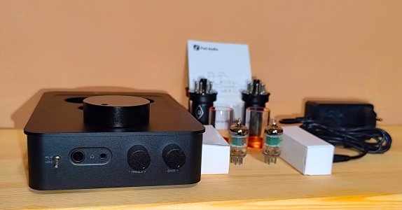

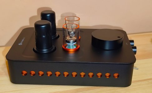

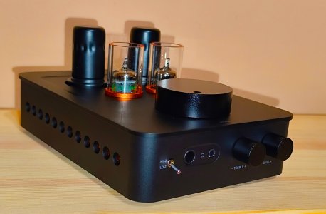

So, the appearance is completely fantastic for me! I simply love it. It's pretty, elegant, modern. Yet it has a retro feel to it because of the tubes. The huge volume knob, which is also the power button, completely dominates the top
The tubes are 5654W and two 6Ж4. The 5654w is responsible for the current amplification, while the 6Ж4 is responsible for the sound. The tubes can be replaced as needed…

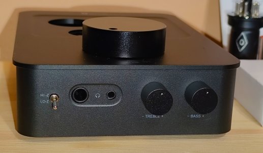

On the front, from left to right, you can find the gain level switch. The two types of jack outputs are 6.3 mm and 3.5mm, then the two equalizer buttons. Unfortunately, for some reason there is no general system in the arrangement of the buttons. For example, in the zp3 and normal hifi components, the order of the treble and bass is reverse. Generally, the bass is on the left and the treble adjustment button is to the right. Here it's reversed. It must have been just a funny, tangled elf who ran into the factory 😊
The high volume button is very smooth. It can be easily switched delicately. A little too easy, I accidentally turned it off a few times. Once you get used to it, it's perfect. The preamplification level is impeccable. It supports the v3 mono at the right level and the volume can be adjusted very finely.

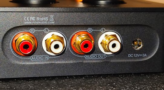

The back:
You can see the serious size connectors, good quality, mountable RCA sockets. The connections are stable. Much more solid than the sockets you are used to. Plus point for the designer!

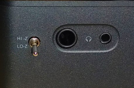

from the side:
The two-sized headphone output is a good idea. The connectors on my older headphones are 6.35mm/ 3.5mm size (but many modern headphones use the 4,4mm.. it's not here)

Let's see how it works as a headphone amplifier: First, I tested the volume with some headphones that I use with my phone. Well, while as a preamp you get plenty of volume, with the small headphones I couldn't get it too loud. The higher output level proved to be sufficient, but the headphone volume was not very much. However, the Fosi Audio i5 headphones arrived. The situation was completely different. The signal level here proved to be ample. When switched to the higher level, the gr70 was already very loud at about half the volume. I'm not saying that they matched perfectly in sound, but they sounded very pleasant. The sound is extremely clean, warm and detailed. The volume control is just as impeccable as if I were using it only as a preamp. The jack sockets are tight, both make good contact. The resulting sound quality is very good. A little spare volume is still missing to be able to drive any headphones. The i5 also feels better if its support is higher. But the GR70 is still very enjoyable in every way. Bass control seems a bit lacking with headphones. preamp mode the bass perfect. Actually, the layout of the tone buttons and the slightly higher performance are the only things that could be mentioned. I really liked the rest.

So sorry, but what FOSI says in the amp's description:
  • Quad Tubes: Features two 5654W and two 6Ж4/6Ж8 vacuum tubes for two-stage amplification. The 5654W tubes boost voltage, while the 6Ж4/6Ж8 tubes handle power amplification. This setup delivers balanced, transparent, and textured sound
So this means, that 5654W tube is a classic voltage amplifier, working in triode mode, and 6Ж4/6Ж8 tube is a classic current amplifier (cathode follower), and finally, in grand total, we have push-pull amplifier with transformerless output (OTL).
I think, that 9002 and 9003 tubes from GE will also great work instead of 5654W.
Anyways, thank You so much for the nice review of the Gr70 headphone amp (y)(y)(y)
