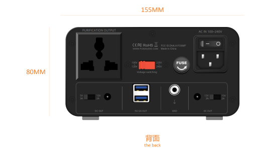

Hello everyone, since we launched products such as DAC and Preamp, there have been customers who have been hoping that we can also come up with a linear power supply to match our products. After collecting suggestions from some customers, we have planned our linear power supply product - PSU20.
1. It has two DC output ports and four levels of voltage and current regulation, supporting voltage outputs of 5V/12/15V respectively;
2. And it comes with two USB ports;
3. Equipped with a purified AC output interface;
Its design concept is to meet the needs of two scenarios: one is the scenario of DAC+Dreamp+Amplifier; One is the scenario of DAC+Headphone; Two USB ports are designed to accommodate devices with other USB interfaces;
Its dimensions are: width * height * depth: 15.5 * 8 * 22cm; the width is the same as our Z series ZD3 and ZA3 (15.5 * 8 * 16cm), making it easy to stack, but the body may be slightly higher and deeper due to heat dissipation issues and interface limitations.
We have created several related IDs but couldn't make up our mind. Now we would like to seek your advice on which front panel ID you prefer. You can vote for your favorite ID and also click on our link to provide your suggestions for the product. Thank you very much for your support!

• Two outputs should be sufficient if they are both user-selectable. Both should have three options 5V/12V/15V to offer all possible permutations. I could use 2 x 5V to power my Allo Boss or 1 x 5V + 1 x 12V for USBridge Signature + ZD3. Others may want 2 x 12V etc etc. Give everyone all options. This is important to ensure broad market appeal.
• The quality of the supply from both of these should be the top priority. This is more important than including additional USB outputs. These must both be Allo Shanti quality or higher. Allo did this for $159USD.
• The two outputs ports could use GX12 connectors (with locking ring) instead of barrel (see below). Some of the Ali-Express units have this so it can't be hard.
• Cables could be GX12 to barrel, with an optional barrel to USB-C adapter (the Shanti does this). Or also include GX12 to USB-C cable as well.
Regards the GX12 connector. I suggest this because I personally think barrels feel cheap and nasty and ideally would not be used on hifi equipment. My impression is that Fosi is doing a great job of the transition from cheap generic looking products such as the BT20A (not pro version) to products that look like actual hifi ie. the ZA3 and this has been a huge factor in the success you've achieved. That's a quantum leap between those two products. Whoever you have in charge of the aesthetic design is doing a great job. You're making affordable products that look like much higher priced ones. Win! Recent upgrade to packaging also a big win. I do think however that with a few small additional changes Fosi could really up it's game further.

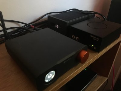

Picked up the Fiio PL50 on sale last weekend to find out what the ZD3 was capable of with a better power supply. Prior to hooking it up I had been reading posts on the ASR forum stating categorically that linear power supplies make no difference so my expectations were low to non-existent.
However to my ears, the difference is clear. I had previously found the ZD3 / ZA3, while a lot of fun to listen to, weirdly both very resolving and somewhat foggy. There was a sense of haze, not overt, but not optimal either. The LPS has improved this considerably. The background is "blacker" and the removal of the fog has allowed me to hear a level of detail and nuance I couldn't prior. Worth noting though, that for me, this system leans a little too far towards the highly resolving but etched / cold side and the LPS has probably only heightened this (I will experiment with op-amps next). Not because there is a chance in presentation (there isn't) but simply because everything is further unmasked and therefore less forgiving. I'm finding it more difficult to listen at volume than I was with the stock supply so as always context is important. At this stage, I'd say the difference is more obvious than the change from 1 x ZA3 in stereo to two in mono. In a system that is close to optimised, with a pleasing tonal balance I think it would 100% be a change worth making.

Sorry, due to global market regulations on universal AC output ports, we were unable to obtain a compliance report. As a result, we ultimately cancelled the AC output port and still retain two DC input ports and one USB input port; The DC input interface supports switching between three voltage levels: 5V/12V/15V;
Thank you very much for your attention. The PSU20 is expected to be launched in June;
