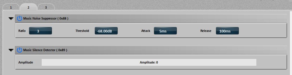

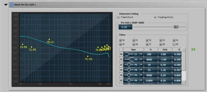

The MC331 uses a DSP chip from MVSilicon. It is possible to communicate with this chip through the USBC port using ACP workbench. There is a tab for a noise suppressor (0x88) and a silence detector (0x89). It is possible to adjust settings and possibly improve low volume noise. I have not been able to save the changes made and each time the amp reboots the default settings are loaded. There is a 4db bass bump programmed into the amp as per the screen shot below. If any one has information on how to make the changes permanent then please post here.
Whoa that's really cool, I didn't know there's a software to do that. If you adjust the noise suppressor temporarily, does it helps the low volume cut off?
Maybe FOSI can get their act together and release a firmware update to write the settings permanently.

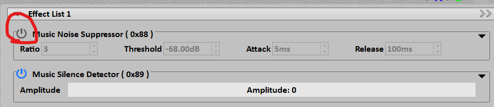

I use the following settings.
This stops the jumping at low volumes and makes the sound more musical in my opinion, as the background gets darker. I mainly use the optical input so your milage may vary.
It seems that the stock threshold setting of -68 is too high and results in the silence detector cutting in and out too often.
There is still a little hiss present regardless of DSP settings but nothing too intrusive. If you run the amp of a battery it improves.

Thanks @doxygenthief, I tried using the ACP Workbench you showed in the PDF, and it did fix the issue with just changing the Noise Suppressor Threshold alone down to -90.00db.
However, I did encounter the same issue, unable to save the configuration.
I tried saving on group 0-9 it didn't stick when I power cycle the MC331.
Also, I didn't know what to write in the group name, I left it KTV the default that popped up.
I honestly can't believe Fosi can't release a firmware that lower the Noise suppressor Threshold to fix this clipping issue.
