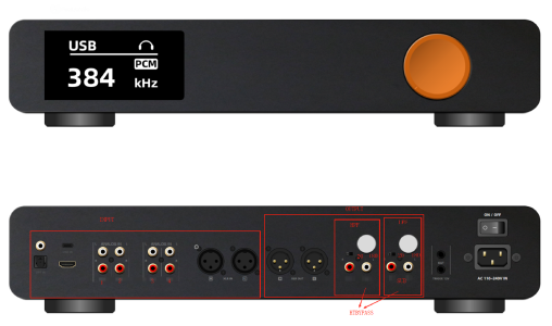

Basic Specs
Input:USB-C, Optical, Coaxial, Phono RCA, RCA*2, Sub-In, HDMI Arc with CEC, Bluetooth
OutputRCA, XLR, Sub-Out
TriggerIn and Out
FunctionsLPF, HPF, Tone Control with Bypass, EQ
In-Built DACAKM AK4493S
Sampling Rates32bit/768kHz+DSD512(USB), 24bit/192kHz(OPT, COA, HDMI), 24bit/96kHz(BT)
Bluetooth ChipQCC3095
Bluetooth CodecsAAC, SBC, aptX, aptX-HD, aptX-LL, aptX-Adaptive, LDAC,aptX Lossless
Remote Control✅

If I have an active subwoofer with its own low-pass filter (LPF), does that mean the one that comes with the Q8 would be useless to me, or am I wrong
Will there be different options for the display or will it be static info display?
I don't quite understand what you mean. Besides static volume, input mode, and sampling rate, do you want to display anything else? Is it convenient to explain in detail?
You can also turn off LPF, which means you have an additional RCA input port and can connect an additional audio source device.

We are also considering using a power socket without a switch, similar to the picture below.View attachment 1834
We are also considering using a linear power supply, but the cost needs to increase. I wonder which type of power supply do you prefer?
Would be very happy to buy a linear power supply, especially if improves sound results. Would it have a similar design and look?

It is more useful to have a RCA preout and a RCA line out
As a general matter every subwoofer has a plate amplifier and adjustable sub frequency adjustment and it looks like the rca outs have defeat switches which is great but just making it a line out is most useful with or without the LPF option and very few are using passive subwoofers

We are preparing to adopt the universal standard gain of 6dB. Generally speaking, 6dB should be compatible with most devices now, right? Or is there any special case where different gain levels are very important to you?
I think that it would be great to have some vent holes on the side as the ZA3 have but also some vent holes on top of the chassi for those who upgreade there unit with other opamps
I understand that a preamp shouldn't generate so much heat that it requires extra vents. But maybe I'm wrong. Personally, I'd prefer not to have them unless absolutely necessary and the unit is as sealed as possible to prevent dirt from entering.

Yes, we have a screen brightness selection function and also support automatic screen shutdown after 2 minutes of inactivity. At this time, the screen will completely turn off and there will be no indicator lights that will light up.
We currently do not have a separate power switch button, and this product does not have room correction function, which would require much higher costs.

Brief Introduction:
The Q8 is a multi-input, multi-output DAC preamplifier equipped with both LPF and HPF functions. Designed for users with multiple audio sources or AVR systems, it serves as a powerful system control hub that brings all your devices together seamlessly. It also helps AVR users build a dedicated 2.1 HiFi system with ease and flexibility.
Here is the rendering sketch of the Q8
Basic Specs
TriggerIn and Out
Remote Control✅
Product Manager in Charge: @Charles
Let’s continue building it together!

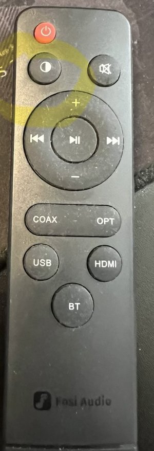

or like the ZD3 you can have a button in the remote control to turn off the screen.
  • IMAGE 2025-07-13 14:15:07.jpg

On another note, will the HPF be applied to the XLR output as well? The image seems to constrain it to the RCA.
