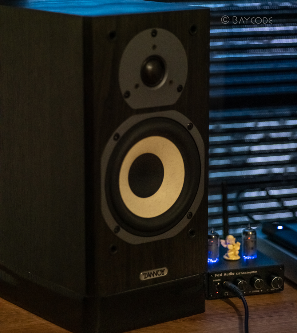

Fosi Audio T20 Tube Amp is a class D hybrid amp which has Line input (RCA connection), speaker output (Banana connection), headphone output (3.5mm stereo connection). It also has Bluetooth 5.0 (with APT-X and APT-X HD support) connection via its BT module and antenna. Although headphone support is stated as 16-64Ohm on the specs I have tried up to 250 Ohm headphones without any issues. Speaker terminating impedance is 2 Ohm - 8 Ohm. Maximum speaker power output is 50W x 2 and Total Harmonic Distortion is stated as THD ≤ 0.04%. Signal to Noise Ratio is also very good at SNR ≥ 99dB. Lets get in to the story and review:
(Above photo: My music angel mini statue shines with deep blue led lights coming from the bottom of the tubes)

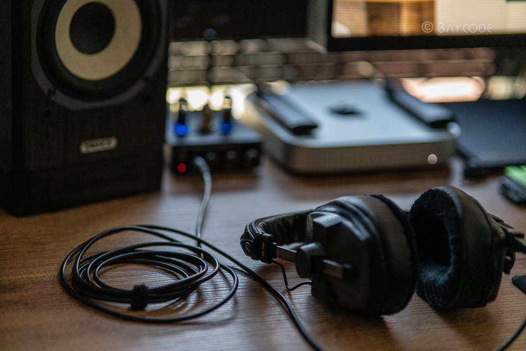

My setup is like this: Mac Mini M2 3.5mm Stereo out -> 3.5mm to RCA Custom Made Cryoed Copper Aduio Cable -> Fosi Audio T20 Tube Amp -> Beyerdynamic DT150 or Tannoy Mercury MX1 bookshelf speakers.
With this simple and minimalistic set up I am getting great sound quality.

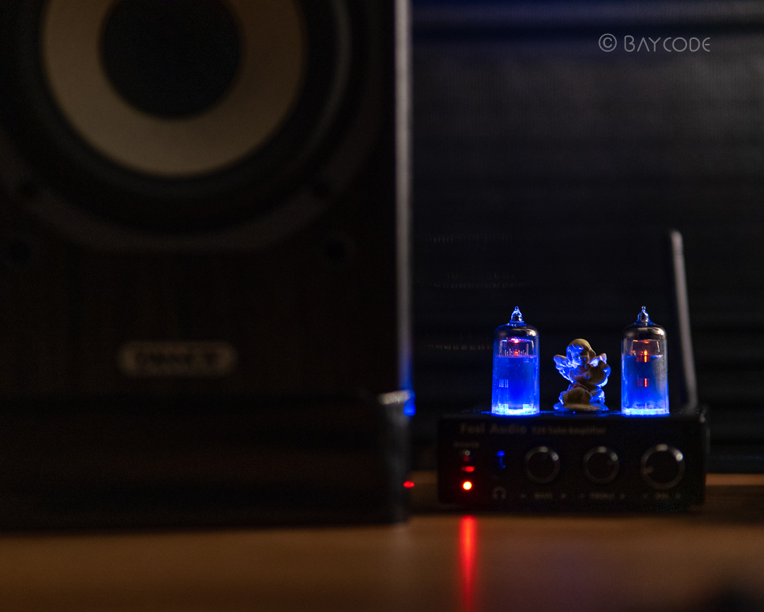

![_BAY2915.jpg _BAY2915.jpg](/proxy.php?image=https%3A%2F%2Fcdn.head-fi.org%2Fa%2F12059493.jpg&hash=d8bfe2da8cac6e5c4cad9f3f94d8374f)

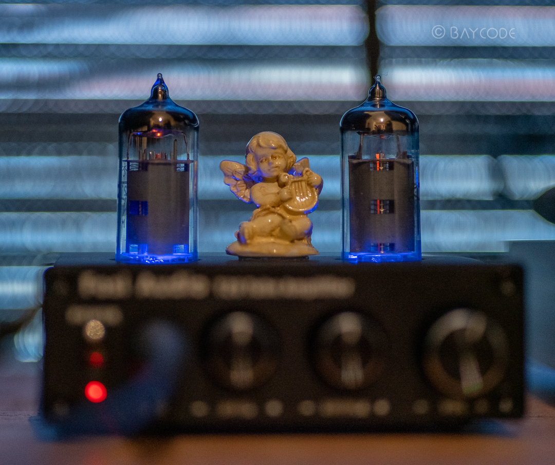

![_BAY2928.jpg _BAY2928.jpg](/proxy.php?image=https%3A%2F%2Fcdn.head-fi.org%2Fa%2F12059496.jpg&hash=3a550f903bfd54b65e0c9d3e1e4380a0)
I have been using Beyerdynamic DT-150 after recommendation from @Lorspeaker . I am glad that I bought that headphone at that time. I really liked the headphone with some music -especially with orchestral music. Some live acoustic recordings also sounded very nice on these... But I never think that it is an allrounder and I never got permanently attached to it. Until now :beyersmile:

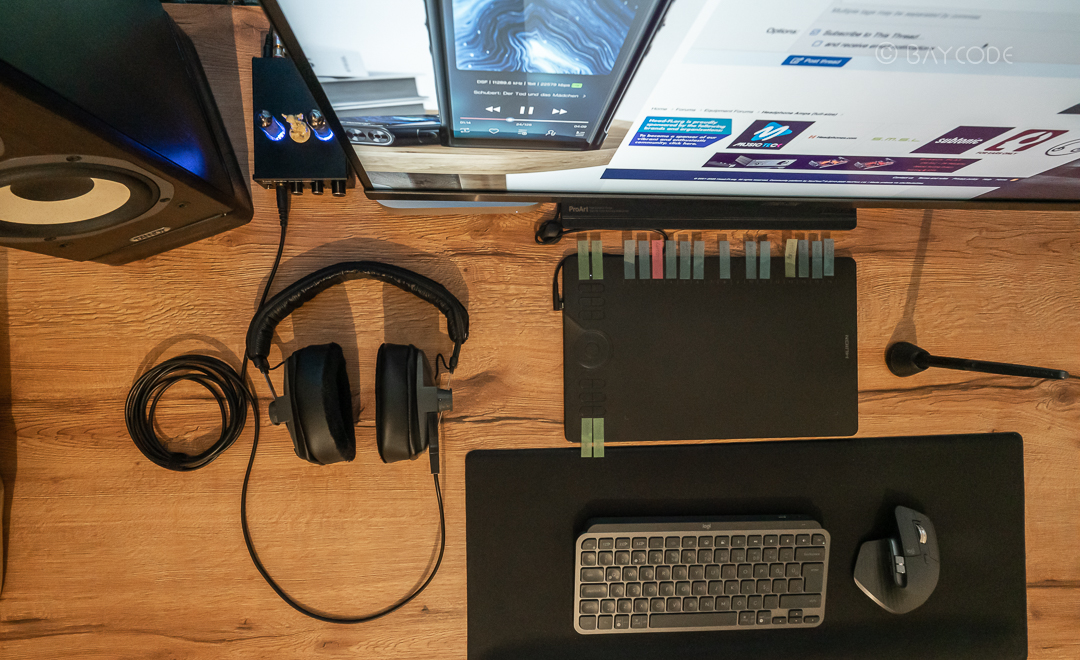

I have been in a research to set up a cost effective, minimalistic and good quality desktop setup. I do Lightroom, Photoshop, Premier Pro and Davinci Reslove work a lot so spend a good amount of time on my desk.
![_BAY2944.jpg _BAY2944.jpg](/proxy.php?image=https%3A%2F%2Fcdn.head-fi.org%2Fa%2F12059889.jpg&hash=b4f43cdf018cf4721aa35e287bdcdea2)
I first purchased a Mac Mini M2 16GB with 250GB ssd. Then I have purchased Asus ProArt PA32UCX-PK monitor, Logitech MX Keys Mini, Logitech MX Master 3S Black mouse, a wide mouse and keyboard pad with wrist rest, a Huion HS610 graphics draving tablet, 2 Orico NVME M2 SSD enclosures which support 10Gbps. Then I have purchased Crucial 1 TB NVME M2 SSD P3 and a Kingston Black 1TB NVME M2 SSD Gen4 and Raid connect these two external SSD's through Thunderbolt cables. Finally I bought 2 Tannoy Mercury MX1 dark oak bookshelf speakers and located them on self made sponge dampers on my desk. At the building period of this desktop system I was looking for an amp which have Bluetooth 5.0 HD Audio support and RCA inputs. Also this amp should deliver both headphone and speaker (at least 2 fronts) output. All these should be in the very limited budget that left for the amp. I also wanted to try hybrid amp sound so I was looking for an amp which have tube and solid state parts on it. I also wanted this amp to have a small footprint. Then I came across Fosi Aduio T20 Tube Amplifier on Aliexpress. Although it is written as tube amp on it it is a hybrid amp. Knowing all these I push the purchase button.

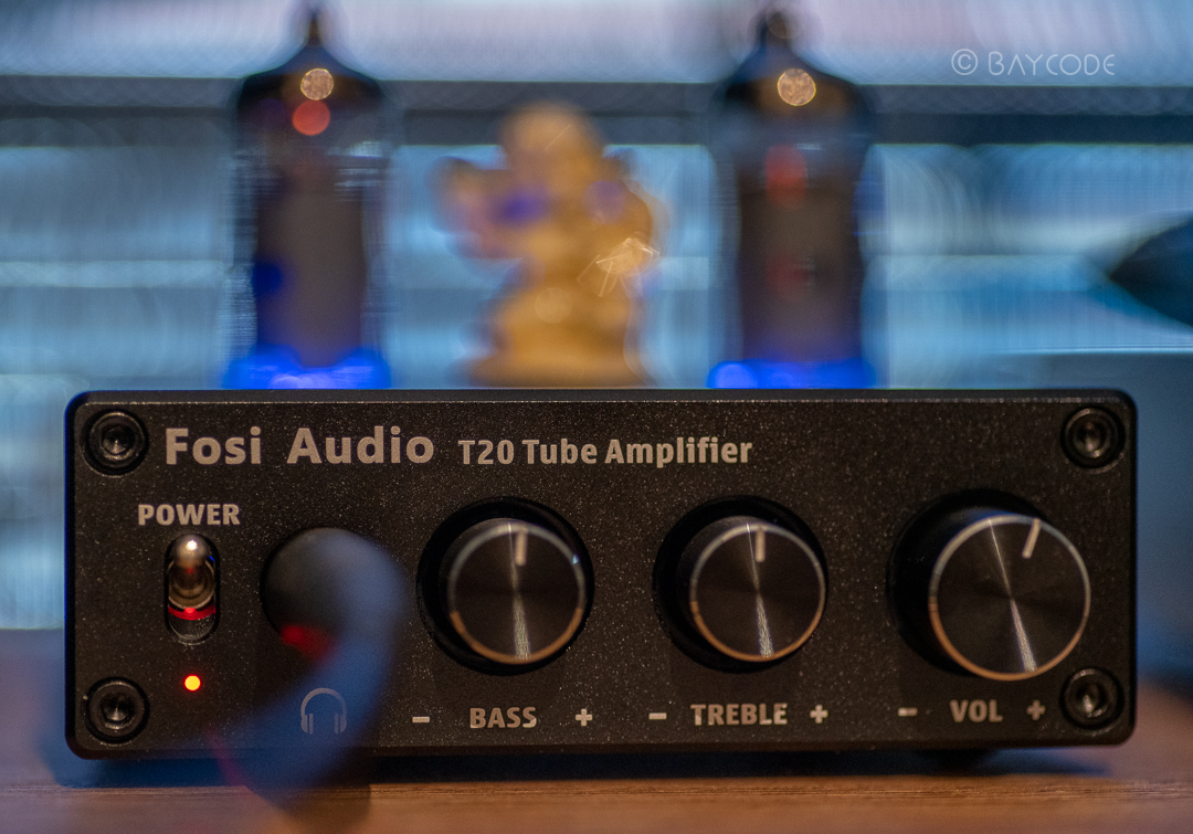

![_BAY2933.jpg _BAY2933.jpg](/proxy.php?image=https%3A%2F%2Fcdn.head-fi.org%2Fa%2F12059498.jpg&hash=0901b3f9b76b567a20624e4ce19cb9f9)
I bought the amp without a power source so it needed an adapter. I first tried it with my old Asus laptop adapter which meets the requirements. Unfortunately the amp delivered a buzzing background noise. So I have ordered a new adapter from an Amazon seller. With the new 24V 5amp adapter background noise completely eliminated. The reason was the ground connection caused the background noise with the Asus power supply. Now I am enjoying the pure audio. In fact after some burn-in and the adapted change the sound quality exceeded my expectations. This is why I wanted to start a review about this amp.

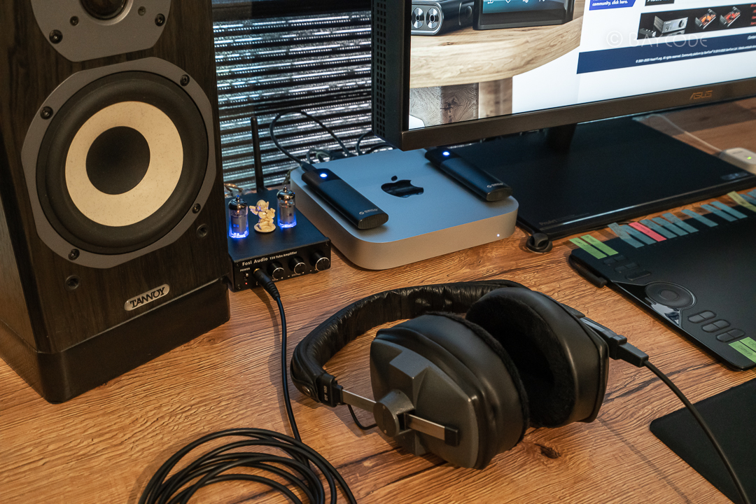

![_BAY2947.jpg _BAY2947.jpg](/proxy.php?image=https%3A%2F%2Fcdn.head-fi.org%2Fa%2F12059890.jpg&hash=aa2c6acfded0f677cf17686a85e7ee52)

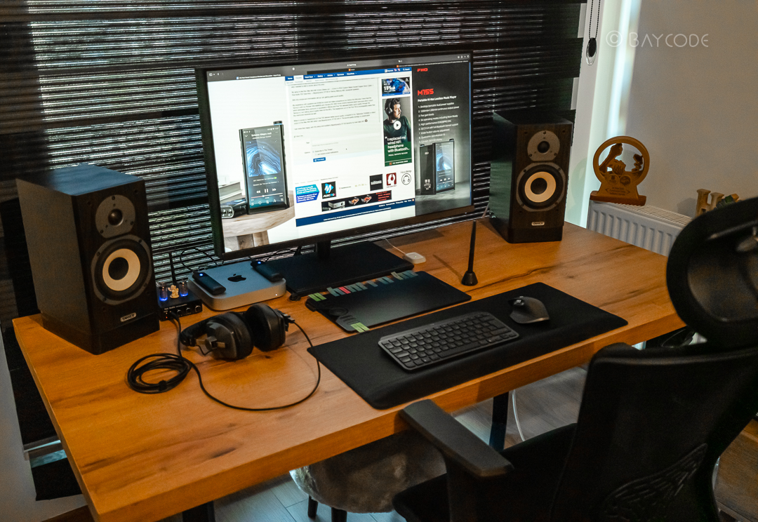

![_BAY2940.jpg _BAY2940.jpg](/proxy.php?image=https%3A%2F%2Fcdn.head-fi.org%2Fa%2F12059509.jpg&hash=870c445849686c9e64c8a7891bde218b)
