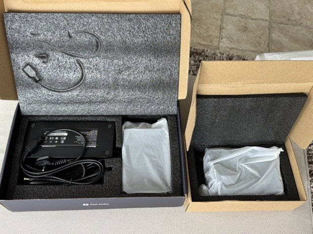

My ‘pre-release’ test unit came in 2 separate boxes:![Prerelease Box.jpeg Prerelease Box.jpeg](/proxy.php?image=https%3A%2F%2Fwww.pragmaticaudio.com%2Freviews%2F2024%2F04%2Ffosi-audio-v3-mono%2FPrerelease%2520Box.jpeg&hash=3a4feb0928f9f9eeade967ca717ec877)
But I imagine the Kickstarter (and the initial retail units) will come in a single bigger box.

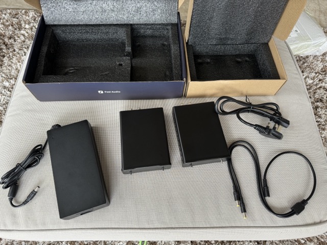

So this is the full contents:
![Prerelease box contents 2.jpeg Prerelease box contents 2.jpeg](/proxy.php?image=https%3A%2F%2Fwww.pragmaticaudio.com%2Freviews%2F2024%2F04%2Ffosi-audio-v3-mono%2FPrerelease%2520box%2520contents%25202.jpeg&hash=1d2ea6d2f21a1bc6653e9e0b5af9b538)
I received one 48V 10A power supply, a UK power lead and a ‘splitter’ to allow this single power supply to provide power to both V3 Mono’s. I believe the Kickstarter includes separate options to either 2 x 48V 5A power suppliers or this 48V 10A power supply.

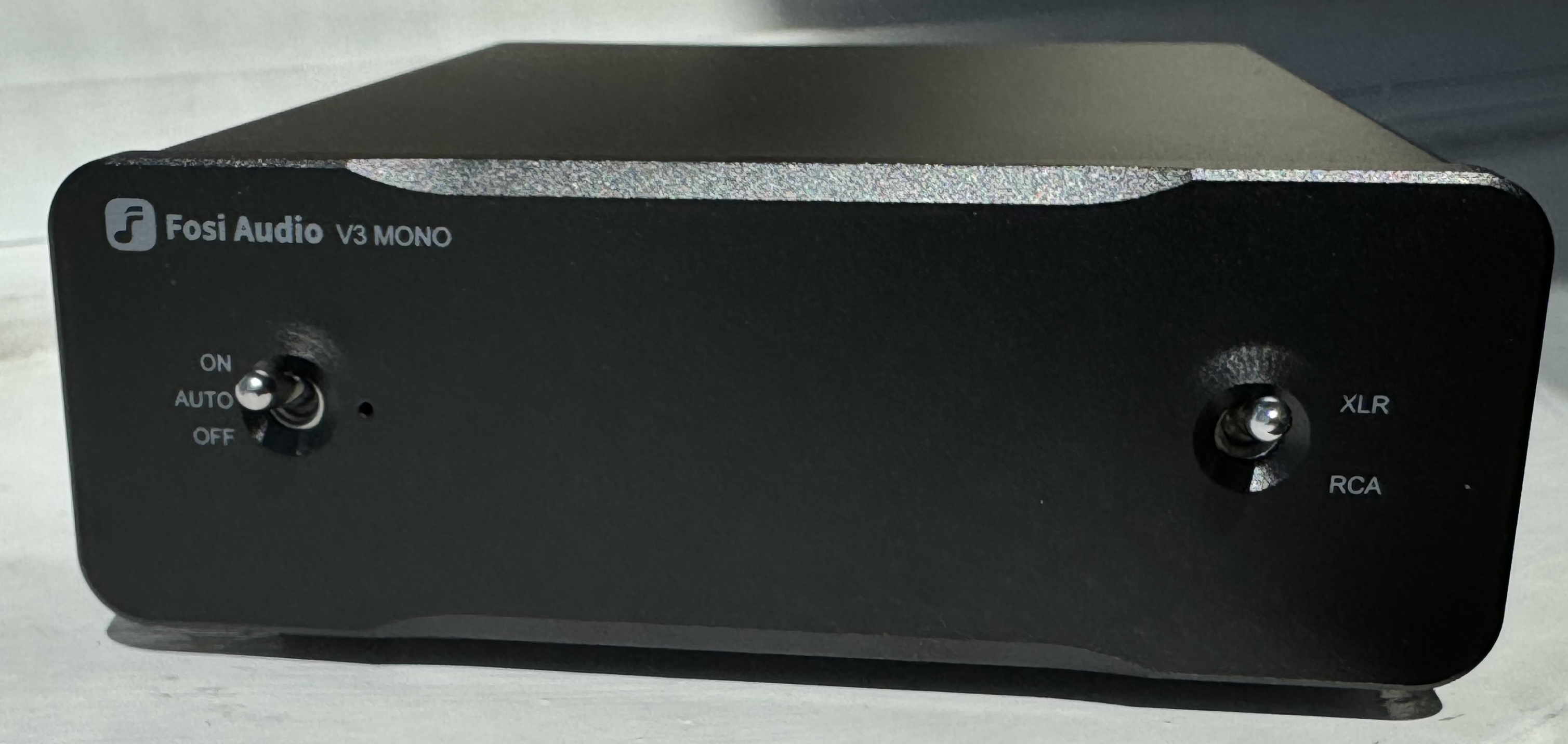

Having both RCA and XLR inputs with a switch on the front in an excellent option.![front-side.jpg front-side.jpg](https://community.fosiaudio.com/data/attachments/0/191-aa0e71827e0bc306146d9191ae608854.jpg)
I used both in my testing from a mixture of Streamers and DAC, though I mainly used the XLR input from my SMSL D-6S.
