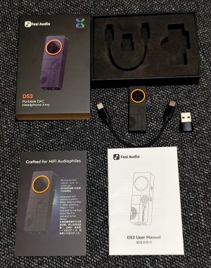

Let's see what arrived, what's in the box? :
DS3 portable dac/headphone amplifier
Usb cable + converter
User manual
Quick Guide

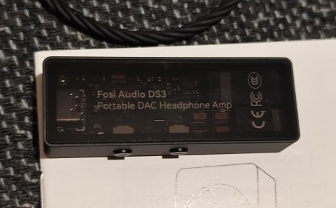

Backside:
Let's start at the beginning. The device is shaped like a small cube. The four corners are slightly rounded. The back is transparent. Under the cover, you can see the electronic components and the color-changing 1pcs LED display. The inscription on it show the manufacturer of the device. Briefly, the technical content and description. The heart of the DS3 is an ESS9039Q2M DAC, which can process up to 32-bit and 768 kHz audio and DSD512 signals. This provides a high qulity, wide dynamic range and precise details, especially for high-resolution music files (dsd flac wav..) and lossless streaming services. The signal processing is carried out by an XMOS USB processor, which ensures fast data transfer and stable operation via the USB-C cable. Whether it is a mobile phone, tablet or even a laptop. According to the manufacturer's description, this is the first portable device to include an XMOS USB processor. In game mode, virtual 7.1 lifelike 360° sound and FPS for precise positioning in games. Very low distortion (0,0003%), high signal-to-noise ratio. Excellent data transfer! You can find more details on the manufacturer's website. Price DS3 now: 125 usd

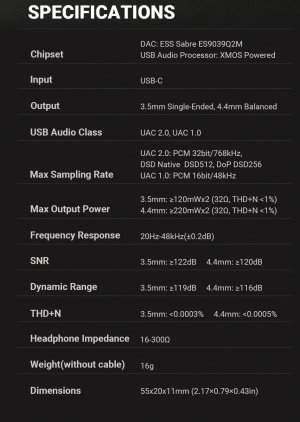

Factory data in the picture:

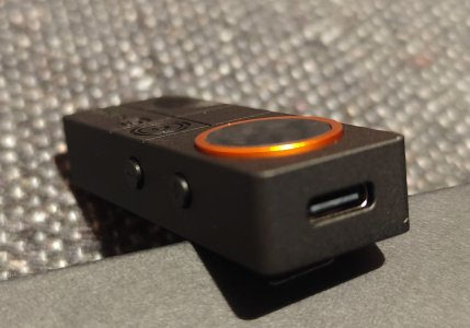

It is available in two colors. Obsidian (black) and Galaxy (silver) These match the colors of the iM4 headphones. They are a perfect match. Mine is black. The case is made of aluminum. The back is impact-resistant glass. When examining the top, you immediately notice a button that looks like a big controll button, with arrows pointing in four directions and an orange frame. This suggests that it could be some kind of control joystick. This is a bit strange, because you would be using it all the time, but it doesn’t work
Right next to it, you can see a split cover that looks like there are touch buttons with a nice design (in the CD, LP style) and some kind of hidden functions, as well as the manufacturer’s name.
Front and two outputs:
Well, we can forget about the top panel here, since these are only design elements. The circular frame and the buttons are just for show, they do not serve any function.

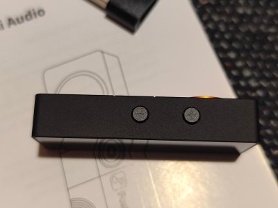

The real control buttons are on the side of the small device, these are the volume buttons:
You can switch between them by pressing them simultaneously, by pressing them briefly at the same time you can switch between the gain level (level 1-2) and by pressing them for a long time you can switch between hifi and game mode and filters. You can adjust the volume according to the impedance of the headphones used (16-300 ohms), or switch to level 1 or 2 due to the desired higher volume level. A color-changing LED provides information about each change.

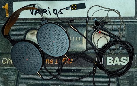

The perfect pair DS3 + IM4:
Complete set:

Up to 32-bit and 768 kHz sound, and DSD512 signal processing
Virtual 7.1 lifelike 360° sound in game mode. Also game sound effects and FPS for precise positioning in games. (unfortunately I couldn't test this because I never play)
Very low distortion, high SNR.
