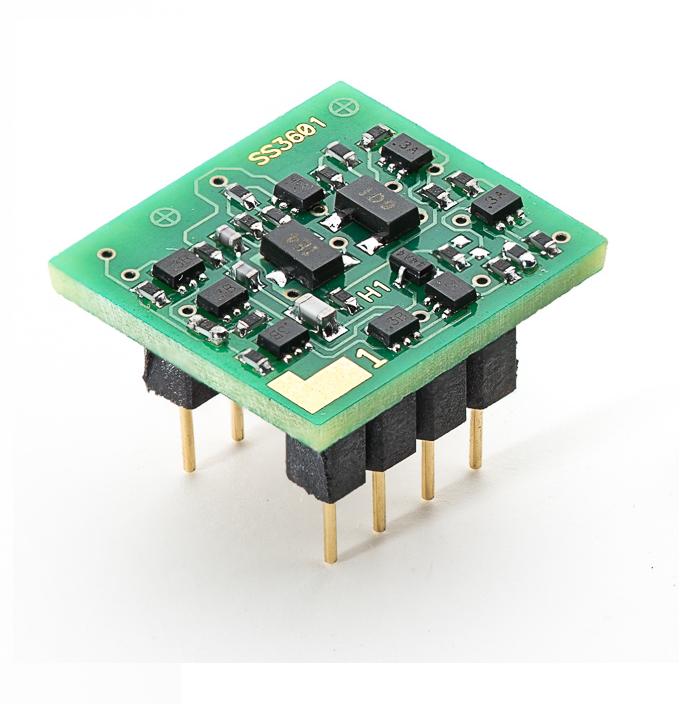

Sparkos Labs SS3601 (Single) Single version.
