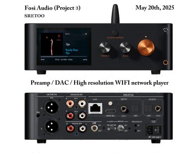

Preamp Q8 Desktop DAC Preamp Development Log
I've heard Bluetooth being used in mesh and/or piconet configuration; enabling wireless multi-device connectivity.
Would this be an in-demand or a useful feature for those who'd rather not run wires for multi-channel/multi-speaker setup?
Personally, I'd choose more USB ports over multiple SPDIF interfaces.
Is the current design include simultaneous (XLR+RCA) outputs? Should it?
Can the analog inputs routed thru the BT circuit for ADC function and routed to one of the USBs?
Orange volume knob has always been cool but that little edge indent is impossible to see or feel... as always...:unsure:
Do you want multi device wireless output?
We support XLR+RCA synchronous output;
Our preliminary design of the analog input circuit is to use an analog circuit throughout the entire process without going through an ADC circuit, in order to maintain the purity of the signal;
What does the edge indentation of the orange knob mean? Can you please describe it in detail?

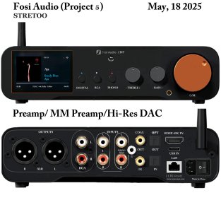

Here is the type of device I would like to buy from Fosi Audio: a preamp-streamer-DAC unit with the usual digital and analog inputs/outputs completed with a RCA dedicated phono input for a turntable, XLR outputs, a LAN RJ45 port, Wi-Fi and BT for broadcast/reception.
The streamer includes a screen that will be useful for viewing the processed stream data (as the picture of the file) as well as data related to the integrated DAC and the device's management menus controlled by the main button.
A little explanation or justification on why I created this integration project is necessary. I already own a lot of Fosi Audio equipment that I am very happy with, but the multiplicity of these equipment shows the limits of the independent device offering, even if they are of contained size. These limits are the following in my opinion: a forest of cables and various connections and an insane collection of power supplies to connect. I also think that the quantity of cables, whether power or audio and digital connections, harms the overall quality of the sound for obvious reasons mainly of magnetic nuisance that generate electrical flows. I would add that the alignment of all these AC/DC power supplies carries a potential risk (short circuit, fire, etc.).
Therefore, I had fun creating a photographic synthesis incorporating my wishes. I should add that for me, a streamer without a screen is not an option because this visual element fully contributes to the listening pleasure in the same way that one can watch the movement of VU meter needles illuminated by a beautiful ambient light. As such, I think that among the subroutines managed by the main button, the VU meter option should be included, not to mention a graphic equalizer and left-right balance.
I have already shared this project with the support team, to whom I have already sent in March 2025 one of the photos of this project. I hope they were interested and that they will be able to consider it in completely or partly. I am well aware that my tastes and solutions will certainly not be those of everyone, but I wanted to contribute in my own way to Fosi Audio’s progress and thus demonstrate that its customers form a true and faithful community of enthusiasts. Here are the simulations of two variations on this idea of preamp with integrated DAC, Streamer and Phono preamp.

Thank you for your kind and constructive comment. From what you have said, it seems that the force you are applying to the volume button is such that you will have the same problem with any other button that requires pressure to operate. Perhaps you could limit your bodybuilding sessions? Personally, I usually use the remote control to turn the device on and off (the "trigger" function does the rest). I only use the rear switch to secure the device when it is not in use for a certain period of time.

Agree with the need for a decent screen if this is to compete with Wiim Ultra. Would you consider taking all the knobs and button functions onto a remote to keep the front panels clean?
Why not but I like these small buttons to materialize the inputs selection. Taking the buttons off would probably reduce production costs, which is a valid argument to offer an affordable device.
